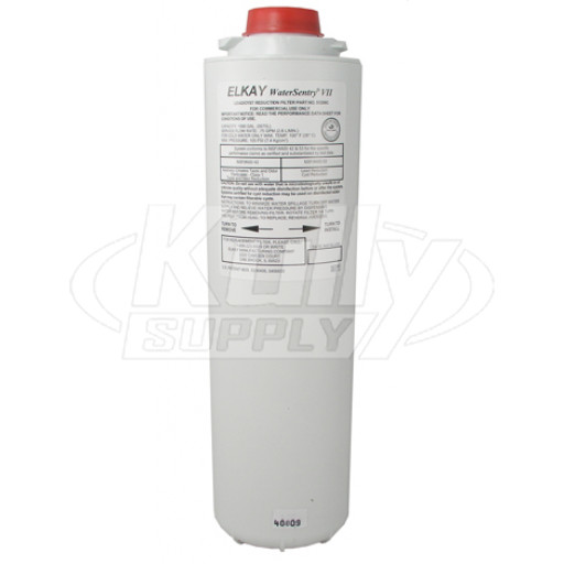

The Elkay 51299C Water Sentry VII Replacement Filter is a replacement filter for the EWF172 filter kit. It is designed to remove cysts, lead particles, and chlorine. It will also remove odors, and improve the taste of the water.
  • For Drinking Fountains
  • 1500 Gallon Capacity

    To access this Elkay 51299C Replacement Filter (for EWF172) (Part #102502) remove the screws on the bottom of the Drinking Fountain and remove the panel that covers the front of the Fountain. After the panel is removed you will see this White Filter located in the inside, lower left side of the Drinking Fountain.
    To replace the filter, you can follow these quick and easy steps:
    1) Turn off the water supply and dispense the water to relieve the pressure from the water lines
    2) Turn the existing filter counterclockwise to remove
    3) Remove the cap from the new filter and use to seal used filter
    4) Insert new filter into existing filter head and turn clockwise
    5) Turn on water supply

    A: To access this Elkay 51299C Replacement Filter (for EWF172) (Part #102502) remove the screws on the bottom of the Drinking Fountain and remove the panel that covers the front of the Fountain. After the panel is removed you will see this White Filter located in the inside, lower left side of the Drinking Fountain. To replace the filter, you can follow these quick and easy steps: 1) Turn off the water supply and dispense the water to relieve the pressure from the water lines 2) Turn the existing filter counterclockwise to remove 3) Remove the cap from the new filter and use to seal used filter 4) Insert new filter into existing filter head and turn clockwise 5) Turn on water supply If you have any other questions our experts are here to help! Call or text 800-518-5388

    A: Typically, it should be once a year OR 1,500 gallons of water.
