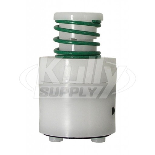

The Elkay / Halsey Taylor 61314C Green Spring Cartridge Regulator Valve is one of the most commonly replaced parts in a drinking fountain. It functions as both an on/off valve and a flow regulator.
  • For PUSHBAR Drinking Fountains
  • Cartridge Only

    This Elkay 61314C Valve Regulator Cartridge (Green Spring) (Part #102539) is designed for Drinking Fountains with a Push Bar.
    The Elkay 61313C Valve Regulator Cartridge (Red Spring) (Part #102489) is designed for Drinking Fountains with a Push Button.

    This Green Spring Cartridge Regulator (Part #102539) is the valve that turns the water on and off when the push bar is activated. If your water is running continuously, the spring has worn or sticks and needs to be replaced.
    Additionally, some Drinking Fountains also have a Solenoid Valve which may be defective. You may also have a broken Push Bar that is mechanically activating the valve.
