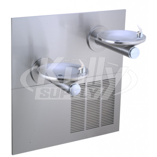

Posted on Wednesday, September 11, 2013 on product Elkay ERPBM28RAK In-Wall Dual Drinking Fountain
0voteA: Behind the push button you will find the cartridge regulator. On the head of that, there is a small area where you will use a flat head screwdriver to adjust the flow of the water. Attached is a parts breakdown for reference. http://www.drinkingfountaindoctor.com/pdf/dfd/ERPB%28V%298C.pdfPosted by Kully Supply on Wednesday, September 11, 2013
