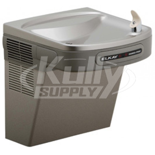

The Filter for this Elkay LZO8L Sensor-Operated Filtered Drinking Fountain (Part #126547) is located on the lower left side of the Drinking Fountain.
Here are the quick and easy steps to reset the Filter Light once the Filter is Replaced:
1. Remove the small, gray access panel from underneath the Upper Shroud.
2. Press the reset button (located on the back of the sensor) in the access opening using a straight blade screwdriver. Hold for a couple seconds.
3. Reinstall the access panel and the Green LED should be illuminated indicating that the visual filter monitor has been reset.
