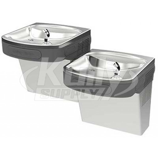

To access the P-trap follow these 3 simple steps.
1. There are 4 screws on the bottom of the Drinking Fountain. Loosen and remove all four screws.
2. Now the entire panel that wraps around the front and sides of the drinking fountain will be loose. Gently pull the bottom of the panel out, and as you tip it away from the drinking fountain you will be able to release the top of the panel from the fountain.
3. You will now have clear access to the p-trap.
To re-install the panel, simply follow these panel removal instructions in reverse order.
