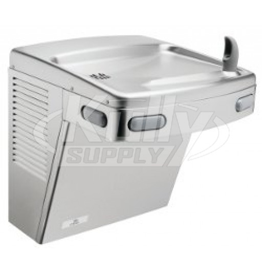

To adjust the temperature on this Oasis P8AC Water Cooler, you will need to access the Cold Control Thermostat (Part #102564).
Remove the lower front panel to access the inside of the Fountain. The thermostat is usually mounted directly on the metal frame bar in the center of the fountain.
You can use a straight blade screwdriver on the thermostat screw to adjust the temperature.
Clockwise=Colder
Counterclockwise=WarmerIf you have any other questions our experts are here to help! Call or text 800-518-5388
