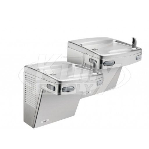

To regulate the water pressure on your Drinking Fountain, you will need to take off the Front Panel and locate the small white Regulator Valve behind the front push bar.
After you locate the Regulator Valve, turn the adjustment screw counterclockwise with a straight blade screwdriver to decrease the water pressure (Clockwise to Increase).
